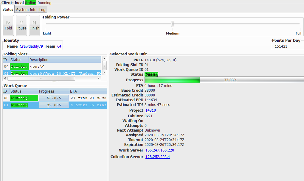

With DarkFoss's suggestions, I downloaded the new beta drivers. Did a clean install. Without baselining, I went ahead and selected the Power Saving preset before starting GPU folding again.
It's been going for five hours now and the GPU hasn't broken 75C. No crashes. I can't put into words the elation I feel when I come downstairs and still see my keyboard lights are still on. I see from the wattage it's pulling (165W -vs 205W) that I was not nearly as aggressive as I needed to be when I underclocked/undervolted it. Even strange is that my GPU PPD has increased by 24k to 144.4k. I only have six guesses as to why this could be.
Thanks for everyone's help and interest with my hardware issues. I hope this is my last post about anything related to it.
PPD proof:

Good tip. After adding the passkey five minutes ago it's estimating 750k PPD and still climbing as it averages out.
That answers a number of questions I had about other peoples' scores. :lol:

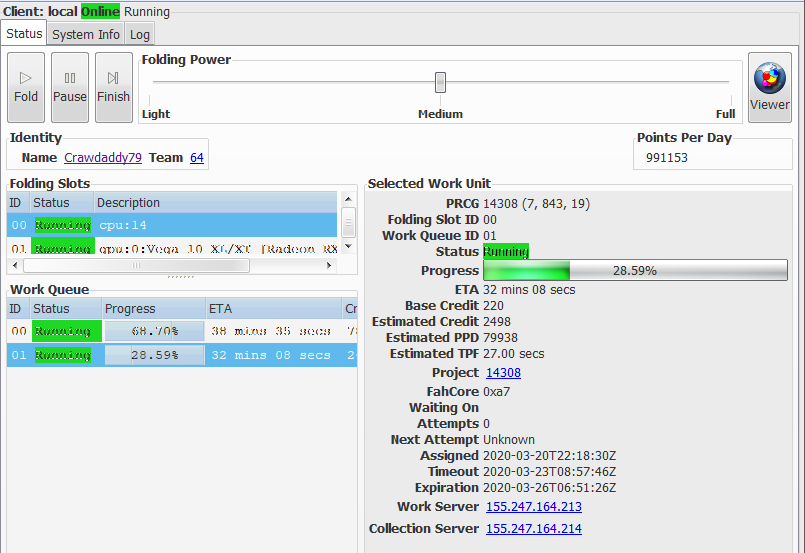

So close.... :mad:
It actually usually bounces around 920k - 950k but just noticed it at 99xxxx and got excited.
The Estimated TPF of Project 14308= 27.00 secs :eek:
I know the Vega is faster than a Fiji but 6 min faster Holy@#?!
